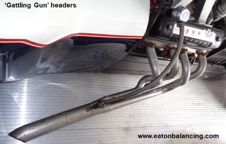

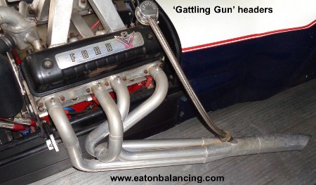

Here's a picture of the headers on my roadster which have the tubes orientated such that the exhaust motion within the collectors is clockwise on one side and counter clockwise on the opposite side.  Being in a roadster chassis frees up many of the space constraints that are present in a full-size vehicle.
http://forums.y-blocksforever.com/uploads/images/70826802-d9b0-44f7-83e2-ef9b.jpg
http://forums.y-blocksforever.com/uploads/images/dd54f351-e266-4290-940a-a9fc.jpg

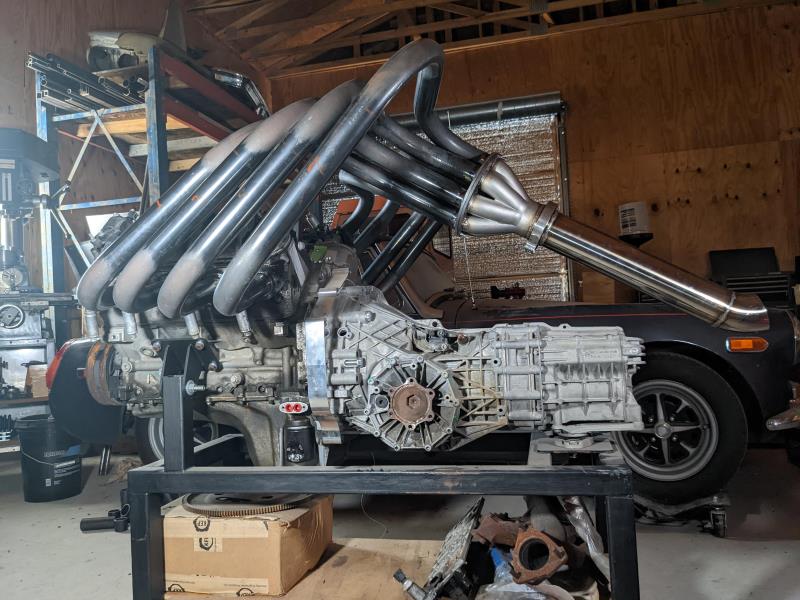

http://forums.y-blocksforever.com/uploads/images/266caf66-b9d4-476e-aa5c-008f.jpg
http://forums.y-blocksforever.com/uploads/images/d79603f4-38c0-4f62-8542-31cc.jpg
dropping down in front of motor is semi reasonable option but the audacity of the upright setup does have some intrigue. sweeping up behind a roots blower with flapper valve on top would definitely be a statement. Probably a literal headache to drive. lengths isnt really something thats able to be controlled with them, just being a close to even as possible. also some are 8 to 4 to 1 for packaging. a flat merge collector would help packaging although next to no information is available on them other than it was tried and dropped.
