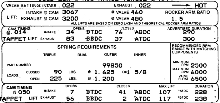

A man at the machine shop said "A lot of cam overlap". http://forums.y-blocksforever.com/uploads/images/32874a09-04f5-470a-bfe2-3598.png

Looking at your cam card, your intake opening & exhaust closing at .014 lift (advertised) equals 71 degrees overlap; however, your LSA (107 + 117 divided by 2) is 112. Isn't 71 degrees overlap for a cam that has a 112 LSA unusual? Ted did mention that there would be less overlap with a 112 LSa, but the numbers still add up to 71 degrees overlap. Am I missing something?

Some more thoughts on the subject.
The 228/238° @ 0.050” camshafts are a common camshaft for both the Ford Y and others on my end.  These do not promote any excessive carbon build ups on the intake valves even when ground on 110° lobe centers.  Your camshaft being ground on 112° lobe centers will have even less overlap at the valves than what you would see with a camshaft ground on 110° lobe centers.
With all that in mind, then I would be looking for another underlying cause.  Oil seepage down the guides is still at the top of my list but here are some other considerations.  You say your spark plugs look normal so for the most part I would rule out excessive oil getting past the rings.   A leak down test would help to ensure that the rings are indeed doing their job.  Something else to consider would be excessive exhaust back pressure which is forcing exhaust pressure to be backed up into the intake tract during the overlap cycle.  The camshaft being installed with excessive advance could also increase the propensity for that carbon build up on the intake valves both from the standpoint of increasing the manifold vacuum and also increasing the amount of time that the open intake valve is exposed to any potential exhaust flow.  And don’t forget the valve lash.  Increasing the valve lash increases the manifold vacuum while decreasing the valve lash increases the amount of overlap at the valves.
