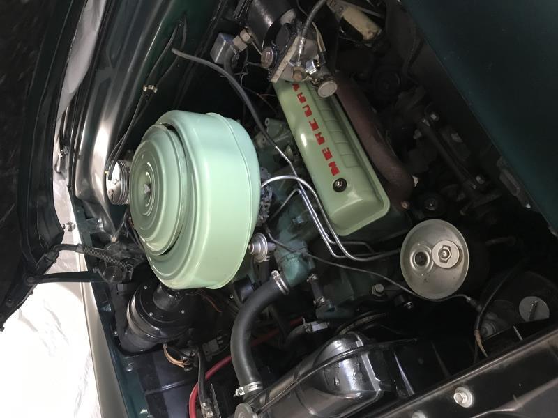

The pump is a 1954 and so is the crank pulley so the sizes of the pullies and the alignment match.  This engine did not always make that horrible noise.  Yes, I did want to make the 292 look like the original 256 including a minor modification to the 256 air cleaner so I could use it on a "modern" Holley 4 bbl carb. on top of an ECZ-9425-B intake.  Today I will first switch power steering belts with another '54 car I have and if that doesn't solve the noise I will switch pumps with my other car to confirm that the pump is the source of the noise.
Now you know I need to see a photo of that ...

http://forums.y-blocksforever.com/uploads/images/091fda76-3f67-494b-8295-7c1a.jpgNo noise with the PS belt removed so I know that the problem is either the belt or the pump.

http://forums.y-blocksforever.com/uploads/images/64a1e80b-a086-4588-8c3f-346a.jpg
https://www.ford-trucks.com/forums/images/smilies2/party0005.gif
Now that, SIR, is ABSOLUTELY BEAUTIFUL!!!
This was mentioned by another member before, but that early engine had a 15/32" W PS drive belt.
Smaller could cause the screech.
The pump reservoir has a filter and full of fluid?
If it turns out to be the pump, please consider having it professionally rebuilt or hang on to it either way.
THANX!!! That photo has made my day and it hasn't even started yet ...
BEAUTIFUL DETAIL ...
