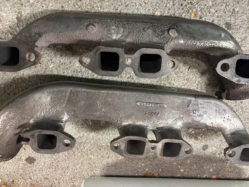

I always thought the passenger side exhaust manifold looked "different" than the drivers side. With the two of them side by side they are definitely different. P/N drivers side ECJ 9431 A, no markings on passenger side The drivers side "collector" looks larger. Passenger side looks "rounder" They both fit the engine and the down pipe fine. Did Ford make different versions of the exhaust manifolds?

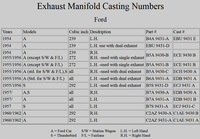

The smaller, round one for the passenger side is pre-57. Both Tbirds & full-size cars use the same passenger-side manifold. The larger, "square top" manifold for the driver side is 57 Tbird-specific to clear the steering box; it's not interchangeable with full-size cars, but it will fit 55-56 Tbirds. The 57 "Square top" exhaust manifolds do flow better than the earlier manifolds, just as the 57 4-barrel intake manifold flows better than the earlier 55-56 intake manifold for the Holley 4000 "Teapot" carburetor.

In 57, as noted, the "flat top" manifolds were std equipment -both sides. RossL (1/6/2026)
