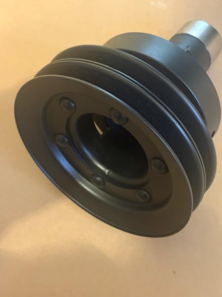

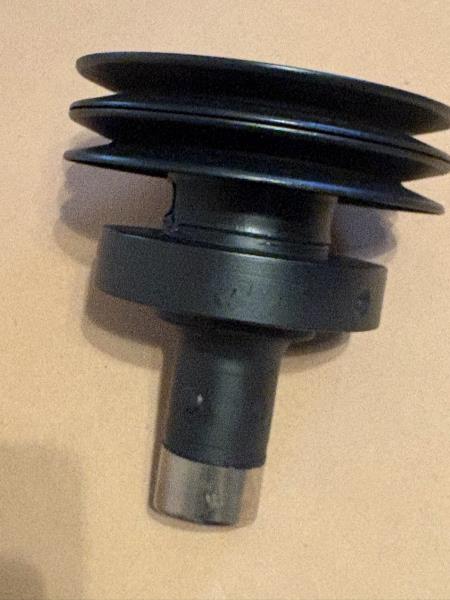

Shout out to Damper Dude fast turn around, great work, fair prices..................  A rare combination in this day and age

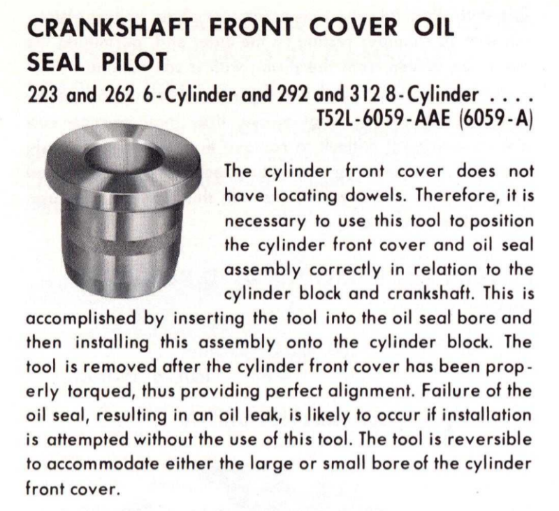

http://forums.y-blocksforever.com/uploads/images/270f08f9-baff-4594-9192-e9e2.png

KULTULZ (1/14/2026)
Where would you find one of those?

FROM A PREVIOUS THREAD - http://forums.y-blocksforever.com/Topic154208.aspx
"The alignment tool you want is T52L-6059-AAE but is impossible to find.  You can use the crankshaft spacer from the 239 engine as the alignment tool, it would do the same thing.  The spacer (B4AZ 6359-A) is easier to find and one is on ebay now for $20.00."

Interesting. I hadn't seen the pilot tool before or the 239 crankshaft spacer. Not being familiar with the 239, why does it use a crankshaft spacer?
