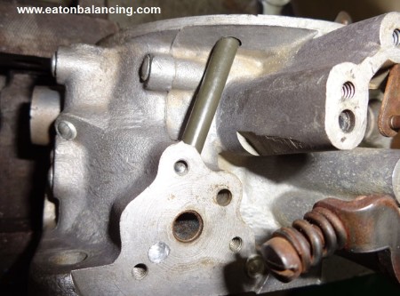

When using a Lincoln Teapot carburetor for the Paxton supercharger applications, I find it necessary to ‘boost reference’ the underside of the secondary diaphragm.  To do that, I add a tube to the carburetor that will pressurize the bottom side of the diaphragm when boost pressure is present.  This allows the vacuum secondaries to function as designed regardless if there is boost pressure or not.  If there is no boost reference to the lower side of the secondary diaphragm, then the boost pressure itself will keep the secondaries from opening by bleeding into the venturi port for the secondaries.  I trust all of that made sense.  The ‘single screw’ small flat cover that allows access to the secondary linkage under the diaphragm must also be modified so that it’s air tight.
If the secondaries do not open when going into ‘boost’, then the likelihood of the engine running ‘very’ lean is high along with the engine performance also being on the low side.  Here’s a picture showing the added ‘boost’ tube on a modified List #1094 Lincoln carb.
http://forums.y-blocksforever.com/uploads/images/5a830f03-f036-460f-96e4-50be.jpg
I am assuming at this point that you also have a ‘boost referenced’ fuel pump for your setup.

Ted didn't notice the second part of your reply.  Yes I did  made  a line ( and a cover to seal) to secondary  housing but from where the choke intake tube line would normally go. I was to chicken to bore a angled hole (and hit it) into secondary vacuum passage. Plan on using a  14 pound electric pump with a  boost referenced regulator and overflow  line back to tank.  Pat  F rebuild S/C and used his info jetting.  Thanks again for tips.
