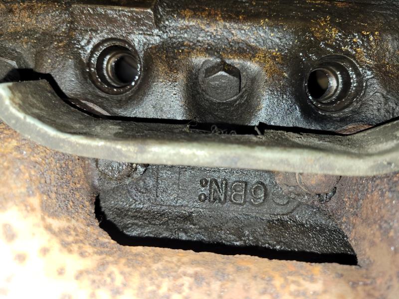

I am having issues finding the casting numbers on my '57 F-100. If they're where I have seen they're supposed to be I am not seeing it.
Possible replacements that have a different ID location?
I will take any advice I can get.
So far thos is the only number I have taken a clear pic of. Time for more brake cleaner I suppose.
6BN, not sure why it posted upside down.

That is the casting date
There are three locations where the model could be
- at the same area you have in the photo but further along
- under the rockers
- under the intake runner
See here for some info and photos:
http://ford-y-block.com/cylinderheadchart.htm
