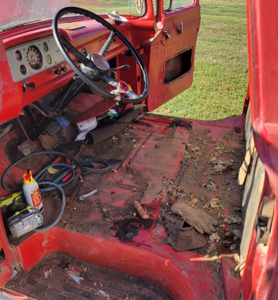

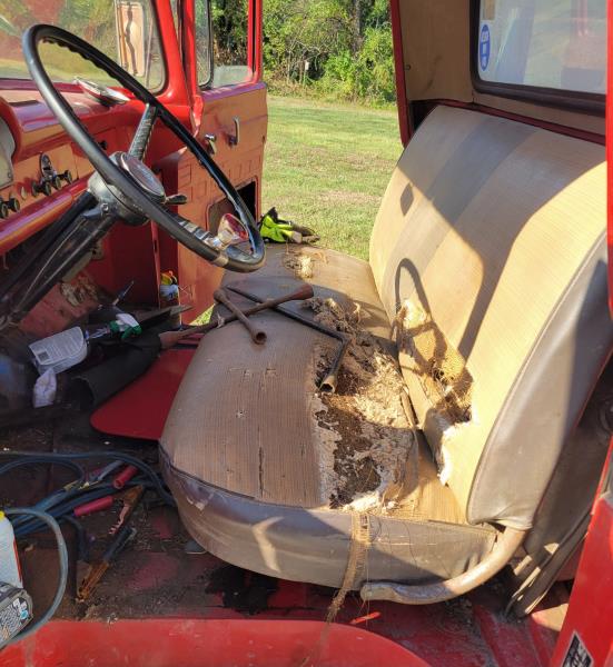

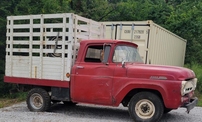

4th generation owner of a 57 F-100. 272 truck with about 70k on odometer. Farm truck so a few dents, bumps and scrapes but overall pretty decent I suppose.
Engine is seized from sitting but I have soaked cylinders a few times. Right now just 2 of them are wanting to hold my concoction so hopefully they'll turn loose in a few weeks and I can get thos thing to pop off with a little bit of gas down the carb.

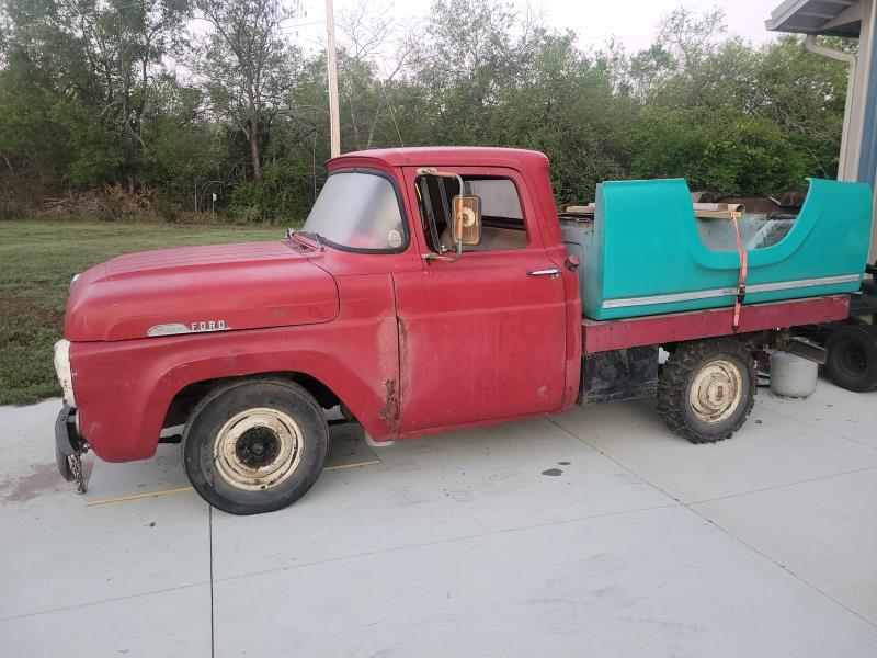

I was looking for grill pieces when I stumbled upon the bed only 8 miles from home.
