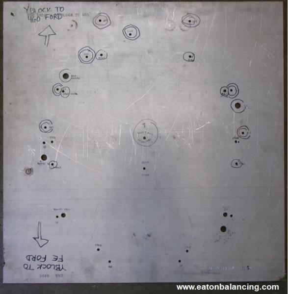

For other needs, I have ¼ inch thick aluminum plates with the FYB bellhousing pattern that I use for making adapter plates that allow the use of non-YBlock bellhousings on the Ford Y.  Here’s a picture of one of those plates.  Those same plates have also been used to make Ford Y adapter plates for the DTS and Super Flow dynameters.
http://forums.y-blocksforever.com/uploads/images/c3eddb86-8f59-483d-9f99-68eb.jpg
