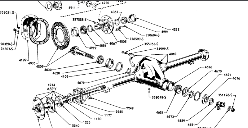

Do '54 Lincolns use a removeable third member or a Dana style with a rear sheet metal cover?

John brings up a good point.  While I do not use any sealer on ‘third member’ gaskets, I will sometimes use some kind of sealer on a rear cover gasket depending upon the cover design.  Also keep in mind that if the third member was designed to use a gasket, then installing without the gasket with just sealer can actually have the axles in a slight misalignment with the differential carrier that holds the ring gear.  I trust that made sense.
Posts: 1.8K, Visits: 306.4K
"Also keep in mind that if the third member was designed to use a gasket, then installing without the gasket with just sealer can actually have the axles in a slight misalignment with the differential carrier that holds the ring gear.  I trust that made sense".
Makes perfect sense ...
