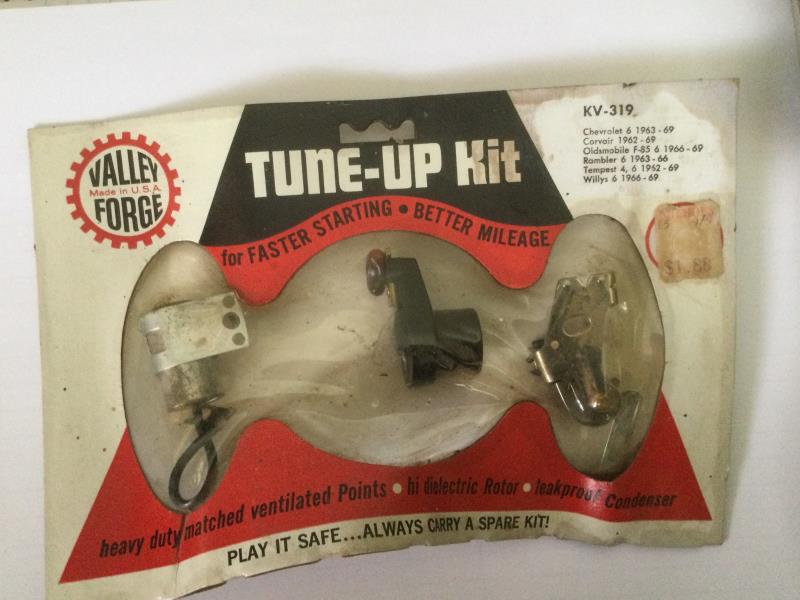

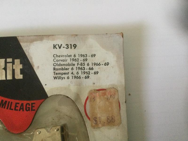

I’m cleaning out my brother’s house, he passed away last August, and I found this tune up kit. Could I use this condenser on my y block? Dennis

I believe some of the tech/shop manuals have condenser specs.  A multimeter test could confirm if viable (?).

I wouldn't use that condenser even if it seems OK.
 A number of variables in a points ignition system, including ballast resistor value, coil resistance of both the primary and secondary windings, number of engine cylinders, coil inductance, and others require the right size condenser for a particular application. Using that six cylinder condenser in an eight cylinder engine may allow it to run for a while, but sooner or later there  will be trouble.

A condenser will degrade with age even if not used. Don't use it even if it measures close to spec .21 -.25 microfarad. That being said, good luck finding a reliable condenser now days.  Sorry to hear of your brother's passing....

I was hoping I could use the condenser since it’s a good old American made one. He owned a ‘67 C-10 with a 292 until he bought a new truck in ‘73.
I have a capacitor tester I used on well pump, I’ll have to see what it reads.

Does it have a spec on it. If it matches the Ford spec it might be ok.
