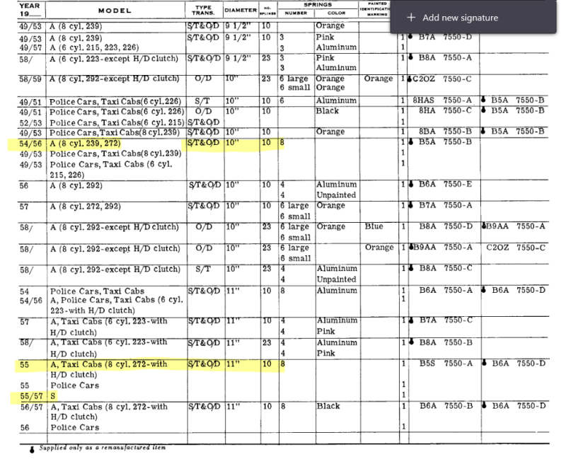

I ordered a clutch kit for my 55 crown Victoria. It said it was for a 55 ford car. When it arrived it was an eleven inch clutch and pressure plate with a fine spline clutch disc. My car has a 10” course spline disc. Was this clutch for a thunder bird? Had to send it back or figure out a different flywheel. After putting everything together my clutch grinds when on the floor and the transmission won’t go into gear I’m thinking bad pressure plate

Is it a 272 or 292? 10in DIA & 10 SPLINE? Are all linkages/bushes good? ADJ correct? Where did you source the clutch?

TBirds came with 11 inch clutches.Most sedans had 10 inches, but I assume some may have come with a 11 inch.

I am not an expert on numbers, but I think the only 55 Ford cars with a 292 were the TBirds. I think the passenger cars such as Fairlanes and Crown Victorias , even the ones equipped with 4 barrel carbs were 272 cars, and probably had the smaller clutch and pressure plate.

"I am not an expert on numbers, but I think the only 55 Ford cars with a 292 were the TBirds. I think the passenger cars such as Fairlanes and Crown Victorias , even the ones equipped with 4 barrel carbs were 272 cars, and probably had the smaller clutch and pressure plate." Your post heading read 11". Then within the post it became a 10". Then again, you described a later 292. Just trying to verify what you have and how it was built and/or modified to try and help. I was just trying to narrow as to what you actually have. Then again, no telling of what the car has been through with service repairs, poor service repairs or any modification(s). 1955 POLICE AND EMERGENCY VEHICLES - https://1955-ford.com/1955-ford-police-and-emergency.html#police-engines

Have you adjusted the clutch linkage before the z bar? Does the clutch pedal hit the floor? most likely it has been adjusted as the clutch wore down. new clutch disc will set the engagement point closer to the flywheel and your concern sounds like the throwout bearing isnt traveling far enough to disengage the clutch. new flywheel will come drilled for 11 inch long clutch or mustang 10.4 diaphragm. for the 10 inch you can get a ram long pressure plate and use a 10.5" clutch disc. good luck, hopefully its a cheap easy fix. Seth
