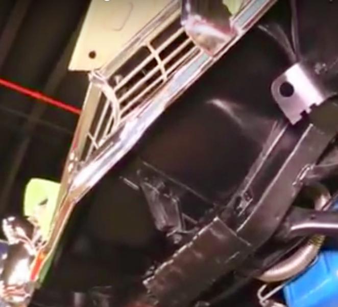

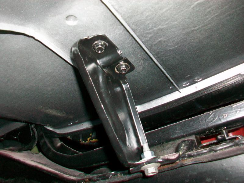

Sometimes, you can push down on the hood (gingerly) while pulling the release. Try and spray the latch liberally with WD-40.
http://forums.y-blocksforever.com/uploads/images/cd049a83-a5d1-44e4-8b60-d8f9.jpg
http://forums.y-blocksforever.com/uploads/images/19c8dd68-6357-41c4-a4a2-f4e1.jpg
They dropped the hood unless possibly the latch had not been serviced (lubricated) regularly.
Its been lubed . I can see the tapered Pin is right through the Latch Mechanism. Shouldn't be all the way through. Latch won't open far enough to let Wide part of pin go back between the open part even with latch retracted. Mechanic must have slammed Hood hard to do that. Normally I just push gently on Hood to close it.
