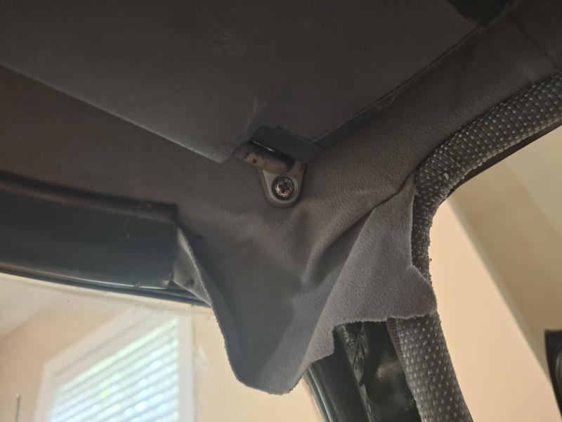

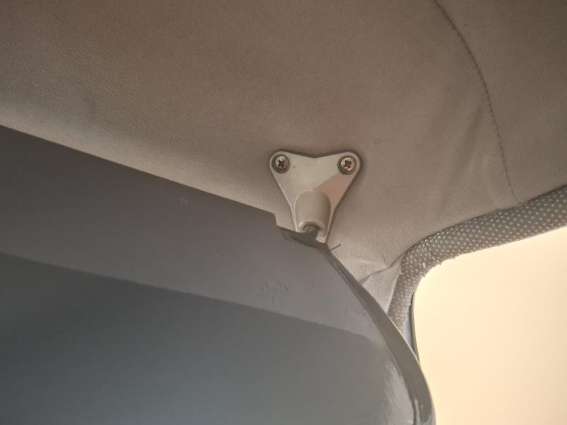

I ended up taking the right-side windshield garnish off and was able to peel away enough of the headliner to get my finger up behind the headliner to feel the holes.  The darning needle did help to locate the holes while I slid the bracket over the needle to maintain the location of two screws until I could get each screw started.  The third screw went right in place.  Since the garnish holds the headliner at this spot I shouldn't have an issue with the headliner once I reinstall the garnish.  I figure I can re-glue the headliner here if the garnish does not hold it properly.
Here's a couple of pics showing the right-side mounting with the garnish removed.  If the left side is different I'll post a couple of pics to show that location but it should be a mirror image of the right side.   I appreciate everyone's help on this.  The last thing I wanted was to put a hole in my new headliner that the bracket is not going to cover up!
