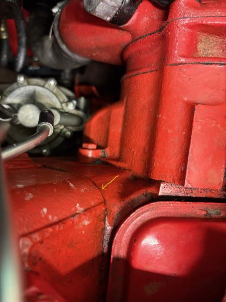

I am familiar with that page.   I do not see the locating "tab" (see yellow arrow)
Top front left side head:
http://forums.y-blocksforever.com/uploads/images/ac1f6be8-f582-4aa2-a933-402d.jpg
Bottom front left head:
http://forums.y-blocksforever.com/uploads/images/380f94b8-7449-4d54-8914-ffdc.jpg

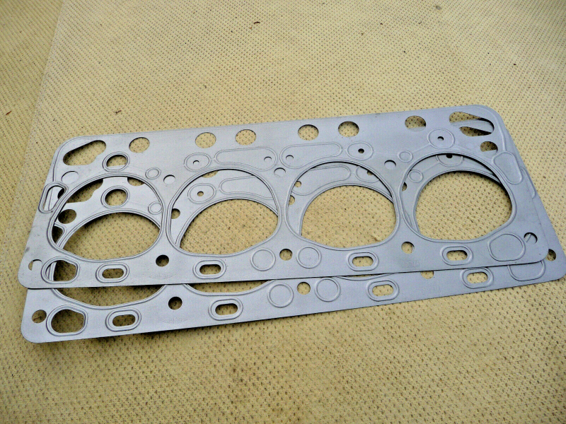

There is no "tab".  As stated in the write up, the gasket has one square corner and 3 round corners.  The square corner go to the front..  From the looks of your pic of the left front, the gasket is on wrong as I do not see the square corner

This video will also help... https://youtu.be/NDR5KLjODis?feature=shared
It is the "7 deadly sins" video for reminders on Y Block engines. One of the sins concerns the head gasket orientation. The video includes good closeups, explanations, various head gaskets, etc.

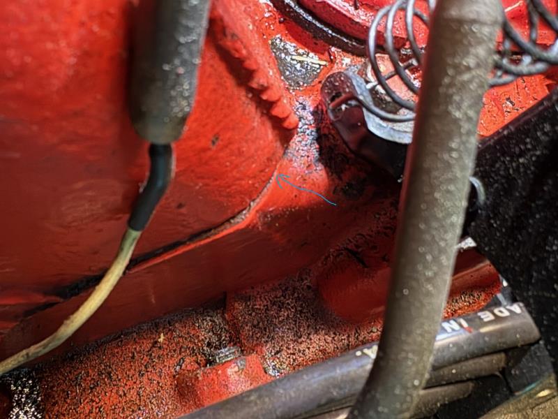

Should the tab be visible on the top rear corner (see blue arrow)?
I don't see that tab on any of the four corners

Honestly, I don't know.    Plus, it is not a "tab"

As you can see from the pictures, the “tab” is really a square corner. Why there’s none showing I don’t understand.
