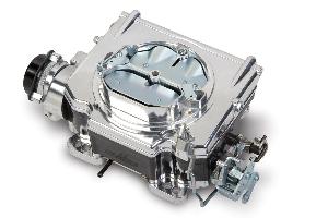

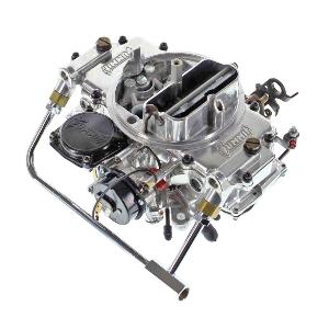

Here are pics of the Summit and Steet Demon carbs which are proven performers on the Ford Y engines.
http://forums.y-blocksforever.com/uploads/images/8205cf0f-26d1-4923-9cd0-f927.jpg  http://forums.y-blocksforever.com/uploads/images/b56332d7-338b-4d59-98a6-5f32.jpg
