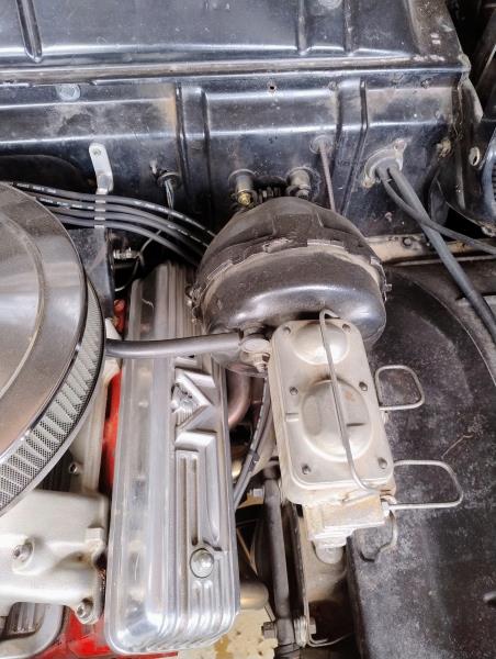

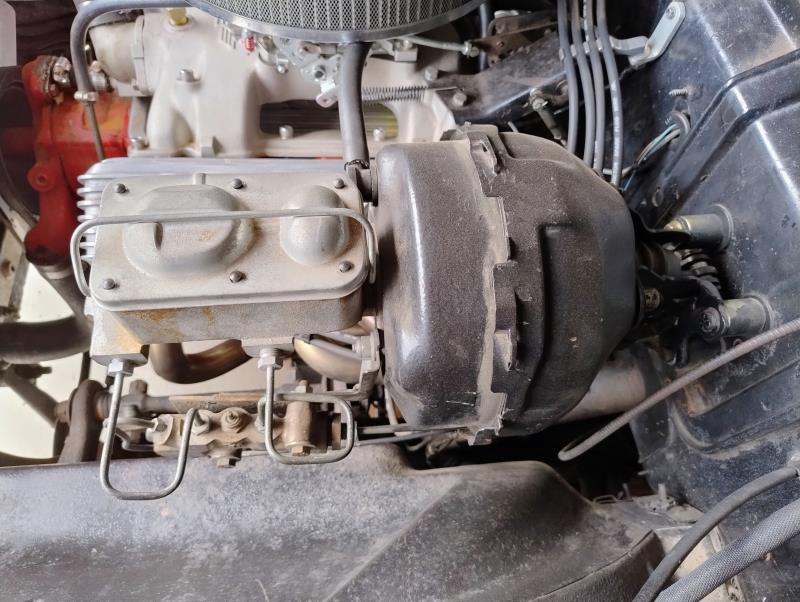

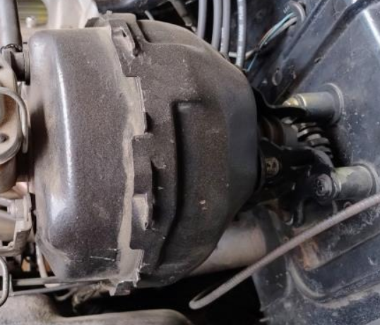

1956 Mercury. As you can see in the photos, the brake booster somewhat dominates the space under the hood. I can't even remove the valve cover without first unbolting the booster.
Disks on front, original drums on rear. What can I do to take less room and improve on this arrangement?http://forums.y-blocksforever.com/uploads/images/345324ae-50e1-4404-af95-ad8a.jpg  http://forums.y-blocksforever.com/uploads/images/0951baf9-b618-466a-a1d5-1644.jpg

Is the MC/BOOSTER part of an aftermarket kit? If so, can you give the vendors name and PN's ?
Do you know or can measure the booster diameter?
How much additional room do you think it needs (booster) to remove the rocker cover?

The car is in Australia now, but the brakes were upgraded in CA back in 2018. I can't see any identifying marks on the booster or MC. However, the invoice quotes 5474009, which appears to be a very common booster code. And NMC1481 which I'm guessing is Napa Master Cylinder and again, 1481 seems to be a common MC code.
The main booster body diameter measures 8" but that increases to 9" with the flange. The flange only clears the valve cover by about 1/2", an extra inch would be nice. Of course if the whole (smaller) unit was flush against the firewall, that might help also. And then I see the Wilwood setup with no booster and wonder if that is an option.

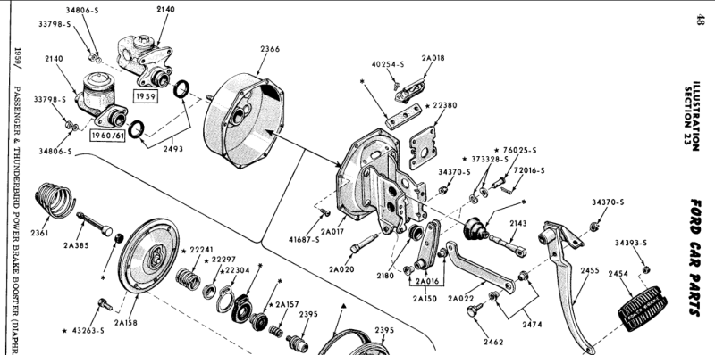

Does your booster the the bracket and linkage at the rear as shown in the lower illustration -
http://forums.y-blocksforever.com/uploads/images/c38d3d3c-2a23-4972-ab60-fa41.png
http://forums.y-blocksforever.com/uploads/images/ab08d380-165b-4e9e-8b74-e05b.png
It s used to raise the booster assy to clear an engine and/or exhaust manifold.
Like mentioned, either a 7 or 8 inch dual diaphragm, hydro boost (will give stronger line pressure) or there is a remote booster available that would work like a 1954/57 FORD/BIRD MIDLAND apron mounted assy. Or you can go with manual DISC/DRUM.
