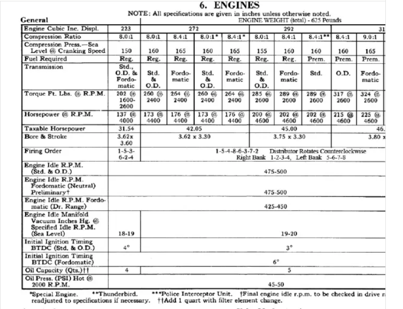

Is this a basically stock engine and if not what modifications? It will not idle @ 475-500 RPM in DR?
You need to get the engine in proper tune (if stock) to ensure correct engagement. This car also has a throttle-valve controlled trans (if not modified) that depends on correct accelerator linkage adjustments. You need a manifold vacuum gauge at the least to begin analyzing.
Again, engine and trans mounts food, u-joints and ant pinion wrap-up?
All of this must be done before pulling the trans ($$$).
Any chance of engine shots to see what you have?
