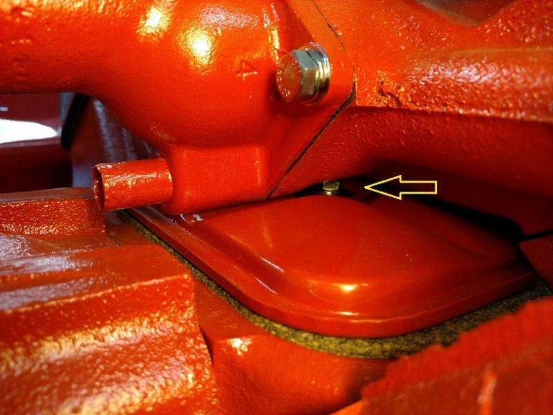

Had another thought on your 3X2 setup.  I am in the process of testing the new Offenhauser 3X2 intake manifold and that particular manifold was not sitting flat on the intake gasket as it should.  This came to the forefront when the engine was not idling correctly and had a couple of cylinders running cold at the headers.
The engine this was being tested on had an aftermarket aluminum valley cover but what I am going to bring up could likely occur with any valley cover, aluminum or otherwise.  The intake manifold was bottoming out on the valley cover bolts and but there was still some clearance between the thermostat housing and the valley cover at this point.  I machined the valley cover bolt heads so that they were thinner and then removed a small amount of material on the bottom of the intake to achieve the necessary clearance without an intake gasket between the parts.  With the intake manifold back on the engine without any gaskets, the thermostat housing was now keeping the intake from sitting square on the heads as it was hitting the front flange on the valley cover.  The thermostat housing was then ground at its bottom to provide some clearance between it and the valley cover.  Now with the gaskets in place, there is some daylight between all the previously interfering parts.
With all this done and the manifold bolted back in place, the engine cranked up and now runs as it should.   The idle on this setup is all controlled by the center carb with the end carbs having the throttle blades closed at both idle and normal driving.  The end carbs (Holley 94’s) have the power valves removed and the jetting increased to 0.055”.  The center carb still retains the stock 0.051” jetting and the power valve is retained on that one.  Idles good and with the progressive linkage set so that the end carburetors start coming in after the center carb is at half throttle, the setup performs as it should.  On the dyno, the wide band oxygen sensor is still showing slightly lean and that’s likely a result of using gasoline with some added ethanol.  Before this setup gets released, I will try jetting the center carb to 0.053” and the end carbs to 0.057”.
With all this being said, an improper manifold fit may be happening on your end.
Posts: 3.7K, Visits: 323.4K
Ted:
Thanks for posting this.  I have found interference with the front valley cover bolt and my '56 factory EDB-C dual four manifold.  This resulted in a broken ear on the manifold.  I re-used an old grommet on the bolt, which is thinner than the present grommets in the gasket kits.  That allowed the bolt to be seated deeper and clear the manifold.  I also have an ECZ-B manifold with a repaired (by a previous owner) ear.  I assume it happened by interference with the bolt head.  I wonder if the valley bolt and the water pump bolts were originally  slightly different lengths and the water pump bolts  were longer and bottomed out when installed in the valley cover by accident.  I have never thought to compare the lengths,  but I always check for clearance when I install an intake manifold.

http://forums.y-blocksforever.com/uploads/images/4c909d7d-ee7b-4543-bfa7-3efe.jpg
