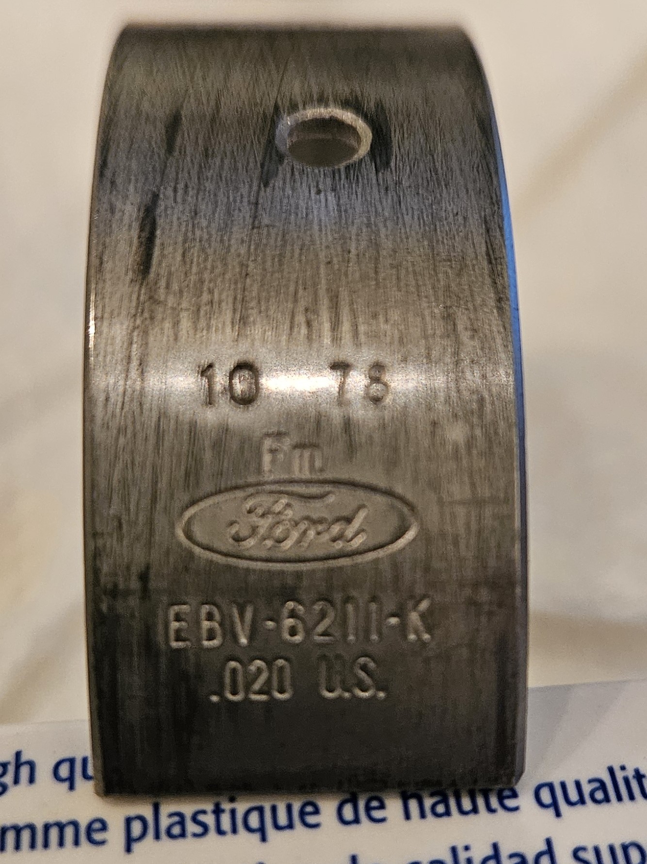

Thanks all for the replies!  Yes the engine has been gone through.  Cylinders are .040" over and the crank is .020/.020 under.  It is an ECZ-A block which means its a 1956 engine, correct?  I tried to add a photo of a rod bearing.  Would 10  78 be a date of mfg?  The main bearings are not Ford and the numbers are very hard to read.

‘10 78’ on the bearing is very likely October 1978 which at least gives a date for when the bearing was manufactured.  It was used sometime after that in your engine.
