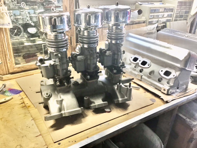

Charlie Price at Vintage Speed has the best 3/2 linkage.  His website is https://vintagespeed.com.  Charlie is the man when it comes to those setups.  All the problems I had were dealing with sixty plus year old carbs. If I had it to do over again, I would buy three new Strombergs. A good friend of mine has a hot flathead with those carbs and he likes them.   As far as the Offy manifold, you should check out Ted's intake manifold test at https://www.eatonbalancing.com.  If you manage to get everything working with those old carbs, you will have a cool looking induction setup that idles like crap and that you will work on for the rest of your ownership.  You say you don't care about performance?  That's a good thing because someone with a single four barrel will blow your doors off.  Sorry if I seem so negative.  Experience does that to you.  Here's a photo of the 3/2 setup on my TBird before I ripped it off and sold it.
http://forums.y-blocksforever.com/uploads/images/ad60a0b2-c195-4d24-85bc-4192.jpg
