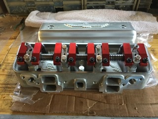

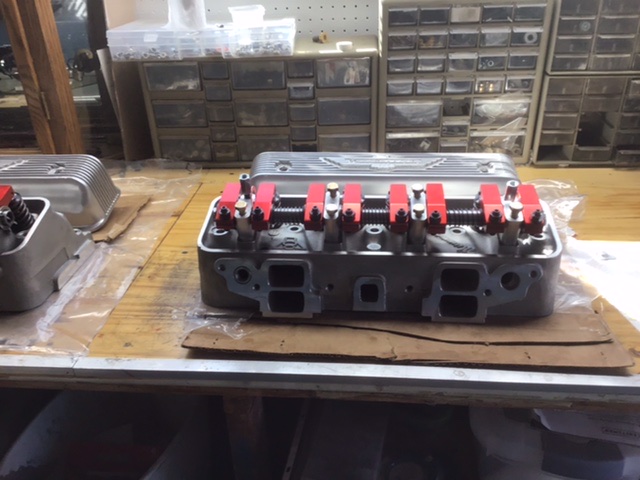

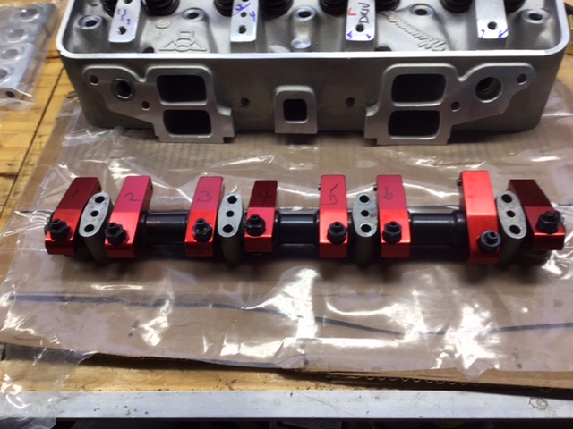

I have set of Dove roller rockers I want use on a set of Mummert Aluminum heads.
The rockers come with solid spacers instead of springs. I’ve done mock ups using both and not sure which is best or why.

I am partial to using springs instead of solid spacers.  Dyno testing both scenarios have the springs making more horsepower than using the solid spacers.  These tests have taken place on both FE and Ford Y engines on both iron and aluminum heads with the results always being the same.  It can be surmised that the springs limit some of the unwanted movement of the rockers when they are at rest.  I do use 0.015” hardened shims for the springs to ride upon so that the rockers are not being worn or chaffed on their sides.
