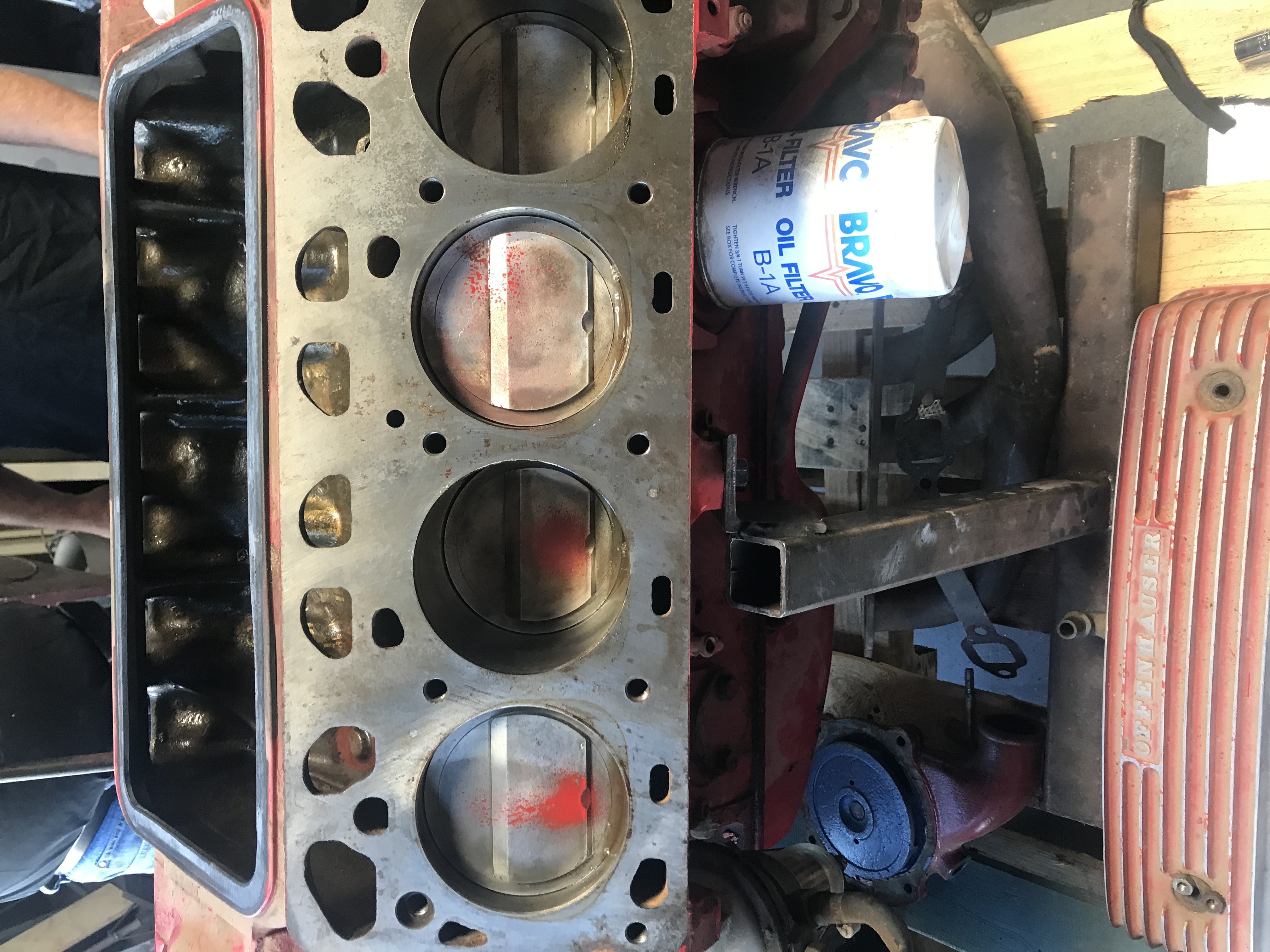

so far the engine has been taken down to a short block. We found G heads with new valves, and what appeared to be a mildl port, the '57 intake was also ported with the center divider completely removed. We determined the block was 292+.20 the valley had also met with the grinder as it was "smoothed" and a coating applied. We couldn't identify the brand of pop up pistons and from the dabs of paint on the piston tops we felt the engine hasn't been fired since the pistons were installed. The crank had no dimple so probably not a 312 crank. At this point we found a buyer, so the engine will move on to next Y blocker. I will put up the pics I took after the teardown.  thanks for the responses an interesting find all in all/
http://forums.y-blocksforever.com/uploads/images/af1c881f-c533-47d9-aeba-072e.jpg

Sorry I was only able to upload the one pic of the block. the message said I had exceeded my limit and wouldn't allow me to post more pictures
