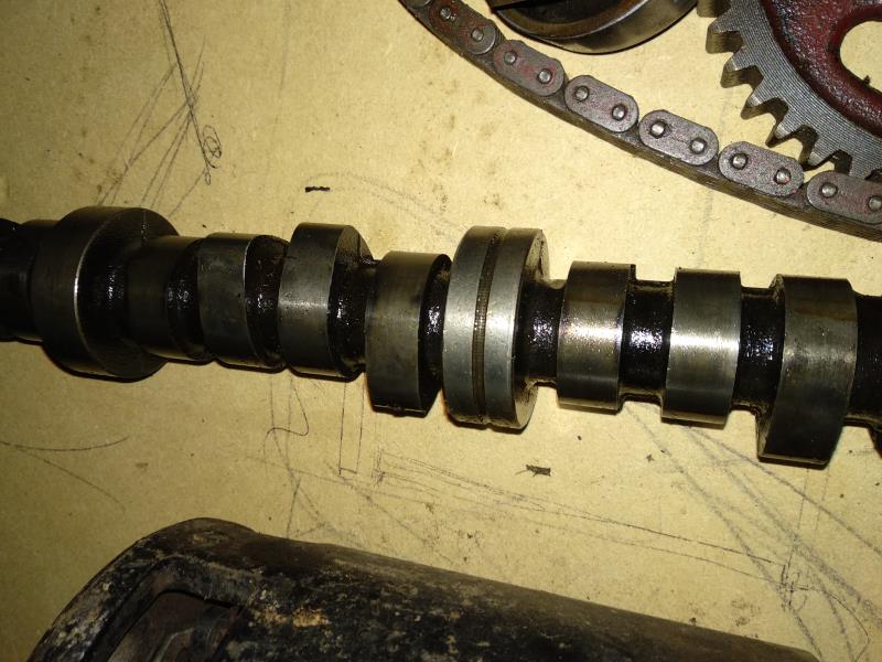

Hey Guys... I taked some pictures...The camshaft marked Fomoco and ECK... And the Block foundry date?

Thanks for the chart.  Ford measured their camshaft durations differently back in the day rather than the accustomed methodology being used today.  For advertised duration, I typically measure hydraulic camshafts at 0.006” off of the base circle and solid lifter camshafts at 0.020” off of the base circle.  Looking at the chart you provided, the specs I posted earlier match up to the 1955 and 1958-1962 camshafts on your list.  The ’56 camshaft also appears to be the same but uses 1.54:1 rockers rather than 1.43:1 rockers.

You don’t mention if the camshaft you have has a grooved center journal or is cross-drilled.  Most ’55 camshafts I’ve checked have the cross-drilled center journals.  Here are the specs for two different 1955 ECK camshafts that were reverse engineered.
Duration @ 0.020”: 233½° In, 239° Ex
Duration @ 0.050”: 197° In, 197° Ex
Lobe lift: 0.253” In, 0.256” Ex
Max valve lift with 1.43 rckrs: 0.366”
As ground lobe centerline: 112½°
Adv duration: 231½°I / 235½°E
Duration @ 0.050”: 196°½I / 198°E
Lobe lift: 0.256”I /0 .263”E
Valve lift: .366”I / .376”E before valve adjustment w/1.43:1 rckrs
As ground lobe centers: 112½°

You can link from here to John Mummert's Y-Block site for listings of casting #s etc. Yes, the C1AE block is a late block. I believe the ECK cam is a later than 1957 very mild cam. After 1957, & the intro of the F.E. big block engines, Ford spec's for rebuilds & so on were for a very mild cam, basically a truck cam..

Hi guys... Recently I purchased a engine with a C1AE block, I take apart the cam and had an ECK casting... What's the specs on this cam is a 55'?
The Block is yellow and had a 55 painted at front side! Would be industrial? The C1AE blocks isn't from 55' they are listed 60' I think...
