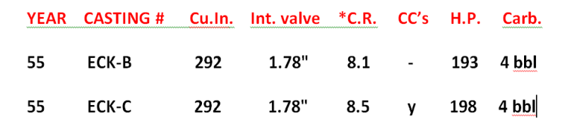

I have a single head marked ECK-C on the outside and ECK-B on the bottom.
John's Head chart indicates the CR is slightly different..
http://forums.y-blocksforever.com/uploads/images/1009ea1b-2868-42cc-8244-4f9c.png
How can I determine which marking is correct (The ECK-C or the B) Does the Compression Ratio translate to the CC size? If so, how is the CC measured?
If one ECK-B and one ECK-C were installed together on a 292, would the 5% CR difference cause an imbalance?

Actually, both Casting ID's are correct. The ECK-C head was modified from a ECK-B casting, most likely calling for a different machining protocol (decking) for decreased chamber volume. The ECK-C ID's it as a higher compression head. A DATE CODE could further narrow it down.
You would want the same head style on each cylinder bank.
You verify CC's with a burrette. JOHN's chart gives a CC footnote symbol but no footnote.

i put these very 2 heads on a 292 years ago.i didnt know they were different until after i bought them.the engine ran fine.

theres a couple of things you could do to measure the difference get a measuring device and turn the heads over put the plug in and fill them with water and measure the difference.another thing would be to shave more of the larger one to match.
