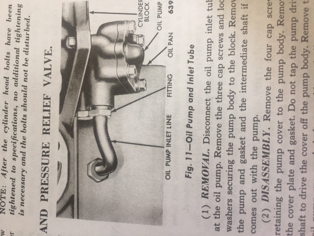

Hi, I am having trouble finding an Oil Pump Inlet Tube! I've looked in many online pubs.  But to no avail.  Any Ideas?  The one I have is leaking because it got screwed up. I'm including a pic from My 1954 F100 repair manual.  Thanks, Bill
Oil Pump Inlet Line.JPG (237 views, 126.00 KB)

A lot of the time, they are on eBay, but with the oil pan.
If it's been crushed at the end due to over tightening of the nut, then you may be able to straighten it out with the help of a hammer  and T dolly.  Another option is to cut off the damaged portion and weld on new tubing.
