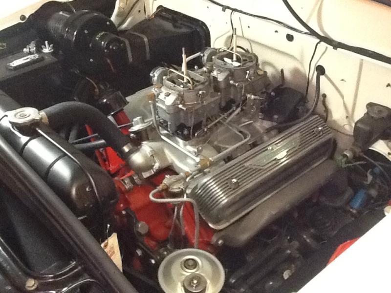

The FM255 has smaller ports than the later Edelbrock as it was made for the 255 Merc. Personally I feel it would work fine on any 272, 292 heads. They had plenty of meat to port match. A smaller port intake usually works better on street engines because of the added velocity thru the intake port when the valve first opens. To me the key to its use would be the smaller Carter WCFB's small base which are a direct bolt on. I use them on mine with progressive linkage and could not be happier. It can use the stock valley cover which also helps. Finding 2 matching carbs is getting tougher but doable. Adapters and AFB's would not be my choice unless you could get 400cfm's.
eBay gives you an idea on value. Also check other engine brands like Olds, Cad, & Buick. For some reason most are about the same as the Ford-Merc for value.
If I were considering dual quads for the street I would not let it get away.
