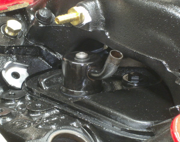

Why not just fix the problem?  The road draft breather is leaking for one of two reasons both simple fixes, the return tube in the breather is clogged, or the breather cover is not sealing because it's on wrong, bent, or has a bad gasket. Take the assembly off the engine, clean it, inspect it and replace it with a new gasket on the engine, and where the cover sits. I've bought at least 10 y-block Fords that i was told had leaking engines that I fixed by cleaning the road draft breather.

A VW fuel pump block off plate will fit the breather hole in the block perfectly.

.When You convert it You will be removing the Road Draft Tube Assembly. Some Members buy a Block off Plate. You can use a Cup type Frost Plug to plug the Hole and screw in a couple of Bolts with flat Washers to fill the tapped Holes in the Block.
