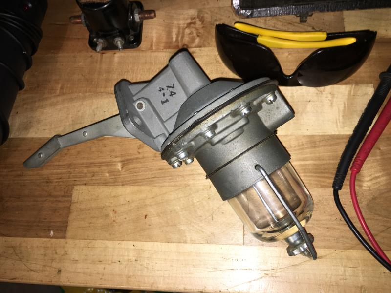

I picked this up a while back. Isn't there supposed to be a paper element filter cartridge and a spring included with these? There is a brass screen in the top. It was rebuilt at one time, but I doubt it would last long with modern gasoline.
Some of these Glass Bowl Ones are referred to as "Sediment Bowl" Pumps. The Brass Screen filters out any large pieces.. They still require an inline Filter before the Carb. If its an old rebuilt Unit it won't last long with Modern Gas. I see all these NOSR Pumps on Ebay all the Time. I wouldn't touch One unless its a newer rebuilt Unit. The old Diaphrams won't last with Today's Gas.
Tedster
Posts: 513, Visits: 153.3K
Yes, it does have a brass screen at the top, I thought they were supposed to have had a filter inside. Hm.
Are modern replacement diaphragms available anywhere that will tolerate the stuff they call gasoline?

http://www.then-now-auto.com/
Try these guys. Great to work with and I was told they mold their own rubber seals.
