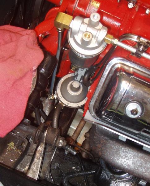

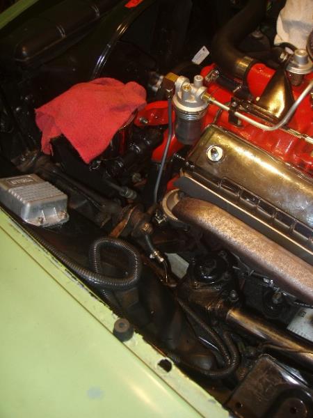

This is an Airtex 362 pump spec'd for a 428 and the plumbing after clocking the ports around.
 http://forums.y-blocksforever.com/uploads/images/c5d5a548-33d0-40ea-ab6e-743a.jpg
The fuel filter is an AC that exactly replaces the glass bowl version that I've now got in a box in the attic.
http://forums.y-blocksforever.com/uploads/images/8606ec85-119f-4514-913f-9764.jpg

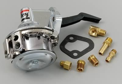

This is the Holley 80 GPH unit for the FE HP application....
http://forums.y-blocksforever.com/uploads/images/408a6fd2-32a2-4b9c-9fe9-4c81.jpg
the 80 GPH number is for free flow - NO BACK PRESSURE. The real number is about half that when there is a carb and filter in the line.
