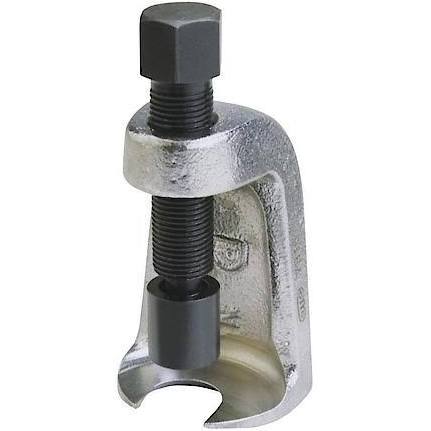

I am trying to get the P/S Control Valve off to get it rebuilt. Having Trouble getting the Stud out of the Steering Arm. Won't move with just trying to knock it out with Hammer as per Shop Manual. Stuck real good. Any Suggestions that anyone else has found Successful? You can't use Heat because of the Rubber . Thanks

http://forums.y-blocksforever.com/uploads/images/133b1c0d-bdbc-4a47-88cd-eeb3.jpg

http://forums.y-blocksforever.com/uploads/images/b53bca37-2b37-4c12-adca-161c.jpg
I have ordered One of these. Don't really want to take a chance on damaging the Valve Assembly. The Shop Manual is kind of simple- use a Hammer. Tried that and no good. Thanks.

The model with the adjustable jaws is the most useful. If you bought cheap CHINESEIUM model, make sure you wrap with shop rag and wear safety glasses while using. Lube thread well, apply pressure gradualy and give a few love taps and it should loosen. 1956 was a long tome ago, even for me.
Sometimes you can borrow or rent from a box-store.
I never liked to use BFH or pickle forks. Too easy to cause $$$ damage.

Thanks for the Heads Up. Tried to borrow either One. No Luck. Ordered from Amazon so if it Craps out back it goes. I don't like using a Hammer for this and I think a Pickle Fork may just damage the Housing.Let U know how it works out.
