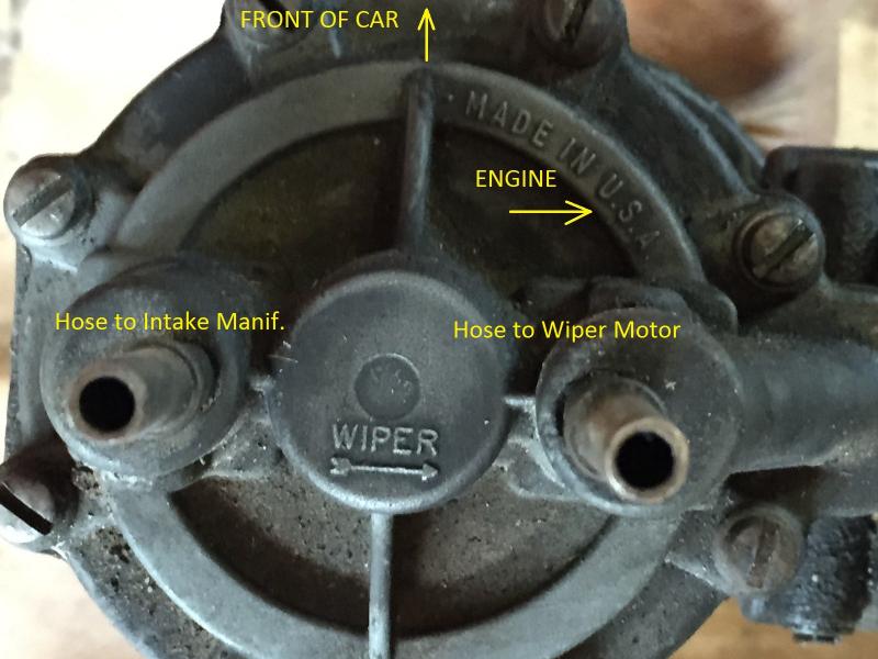

                Does this help?
                Posts: 160,
                Visits: 35.5K
                It looks like the tubing closest to the block is going to the wiper. That is the IN port on my fuel pump. Thanks for the picture.

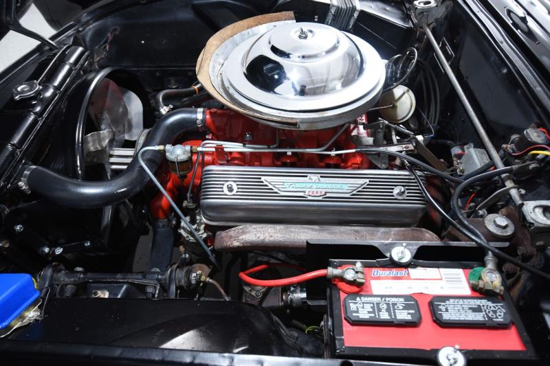

                Maybe this will help   -
                Posts: 160,
                Visits: 35.5K
                Thanks for the photo. The IN port does go to the wiper motor.
