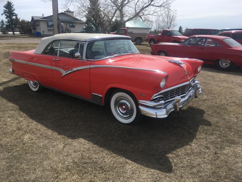

I finally got the car last Night after waiting 2 Weeks while it was shipped. It looks like I might have gotten lucky because the Wire Covers look to be replacements which don't use the Springs etc for mounting. The Tires are WW Radials.http://forums.y-blocksforever.com/uploads/images/de9aa48f-2daf-4e7f-9722-6101.jpg

all I can tell you is they are beautiful and a pain all together! breaking the outer bead of the tire works best for me but it can be done by deflating the tire. if you are running radials i wouldn't attempt it. they rub on a radial and mar the white wall. and good luck keeping them on and keeping them from squeaking. ask me how i know!!!! work fine with bias ply tires and the clips are easy to install once you start looking at it you quickly figure it out. i have been buying the updated version that locks on just like a hubcap. love them!!!
