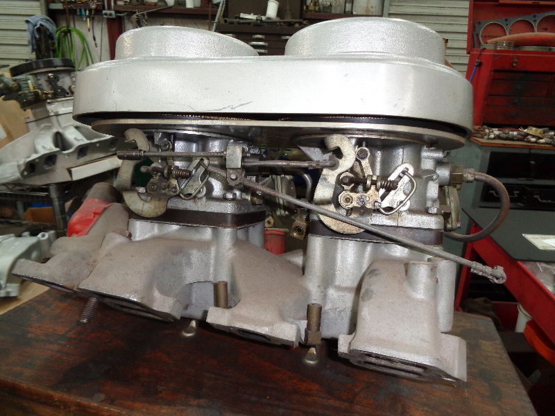

Does anyone have a picture they might share of the original linkage used on a dual application on a car? Not a T Bird.
I run 2 Teapots on my flathead with a very simple linkage arrangement, but would like to see what was done on the Y Blocks.

That's a lot of carburation for a flathead when 2 2BBls is considered max for a street engine (in straight linkage)
Here’s a picture of the factory linkage for a ’57 Ford dual quad setup.  You’ll not be over-carbureted with a pair of Holley Teapots on the flattie.  The vacuum secondaries will be very forgiving in insuring that the engine receives only the cfm it needs.  If you would like the Teapot secondaries to open more correctly, then you’ll need to replace the factory silver secondary springs with the long yellow springs that come in the Holley spring kits for the 4150/4160 Holley carbs.
http://forums.y-blocksforever.com/uploads/images/0ac74108-55e3-48fe-8ebb-2b95.jpg

Yes, Ted
I have replaced the secondary springs.
Carbs run well
