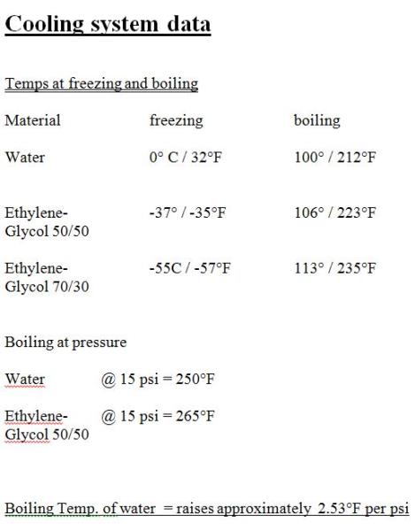

Water boiling temp raises about 2.5º per psi - its a little more for the anti-freeze mixtures, so that is a good minimum estimate.
http://forums.y-blocksforever.com/uploads/images/50056335-879e-48fd-997b-5c7b.jpg
When designing a system to avoid a boil-over, the automotive world has used both chemistry and pressure to do the job. Here in Tucson I went to a shop that specializes in desert pick-ups and had them rebuild the T-bird rad. Easily runs the 15# cap - and I run ethylene-glycol to get the chemical edge as well. My guess is that when Ford engineering had a relatively big truck radiator to work with - the pressure cap could be safely reduced. The T-bird rad is about 2/3 the size of a sedan and needs all the "edge" it can get.
