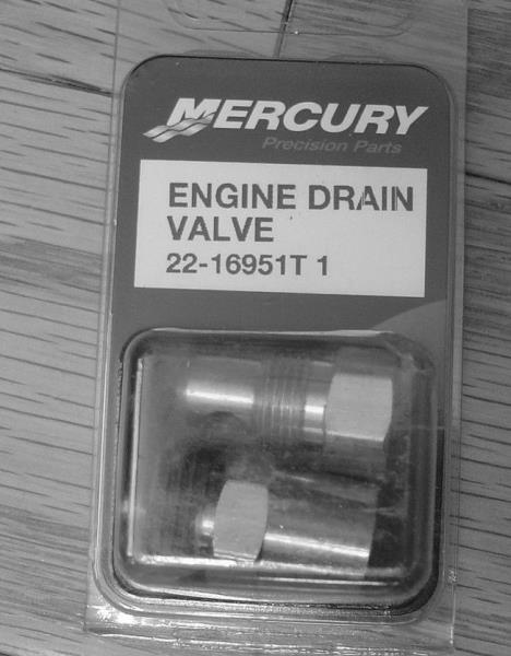

I have run across a neat drain valve that fits the YBlock and is a marine item.  Fits the radiator too.  All you need is a 9/16 wrench to open it.
Available through a marine supply store or on ebay.  All brass.  You can even put a 5/8 hose over the end to direct the flow.
                               http://forums.y-blocksforever.com/uploads/images/8e876f2d-3937-4f4f-8991-b8a2.jpg
