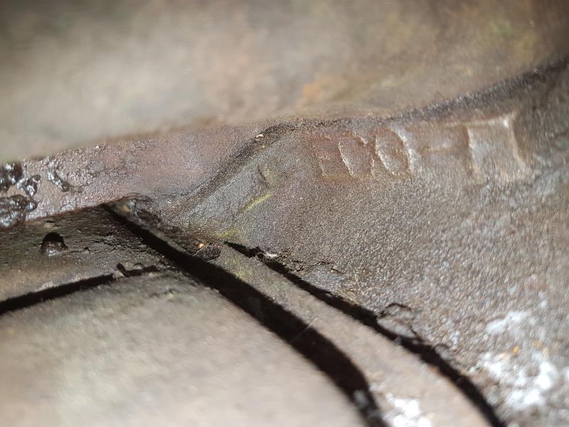

ECGT I am looking to find out chamber size.Valve size and anything else anyone can share.Can't seem to find anything.

UPDATE -- MAJOR ERROR ON MY PART
THE B6A 6049 M IS THE CORRECT PART# FOR BOTH CASTING IDENTIFICATION  OF ECG -"T" AND ECZ- "C"
DOES NOT INCLUDE THE "H" CASTING THAT I ORIGINALLY THOUGHT !!!!!!!!!!!!!!!!!!!!!!
The "T" could still be the Canadian cast version.
I simply missread a line. Please accept my apologys.

The casting number of ECG "T" transfers to a Part # of B6A 6042 M
Used on a bunch of different engines in 1956 .
Used on the 272 , 292 , and 312 with both stick,O.D. and FordMatic trans.
Odd that it does carry the same part number as a cylinder head with a casting of ECG - H - Also used in the 1956 production
If I was a bettin man I would think that the same specs would  apply for the "T" head as what the "H" head would be since they share the same part number of B6A 6042 M
Check Mummerts site for the specs on the "H" heads

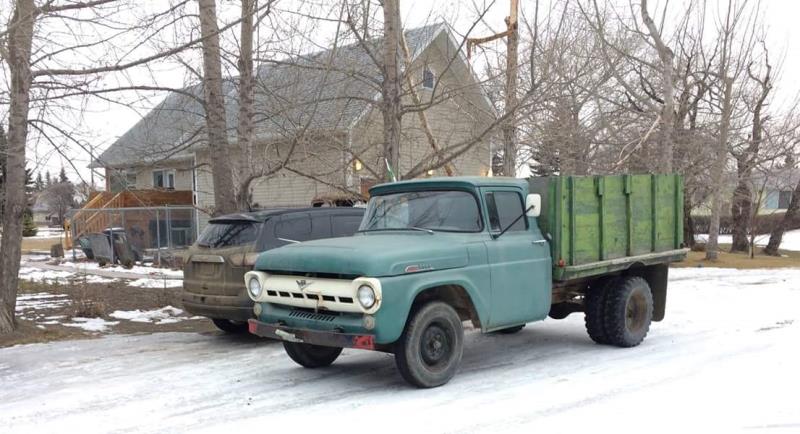

Oldmics that is very interesting.The "H" head is a 56 power pack head is it not?
I found a stray at a friend's on a 56 car so started wondering wjat they were.
I have them as stock equipment on my 57 one ton.(Canadian)

I did originally think that the "T" head cast was for trucks. A trip to my books negated that thought.
I did then consider that it might be Canadian.
Perhaps the cast identification differences are exactly that !
The "H" head is the Power Pack head.
Its U.S. designation for the "H" head is part# B6A 6042 M while the "T" head may have been the Made in Canada version.
Check the "T" head that you have and see if it has a Walkerville or Windsor casting identification.
That would tell us whats up.
Oldmics

Posts: 78, Visits: 2.5K
Oldmics even if they are C heads I wonder if they are a posted equivalent.They have no front plugs.As our Canadian C heads still had plugs in 56.I am 100% positive these untouched stock pieces on engine.I will have to try and talk friend into letting me pull the single head.
