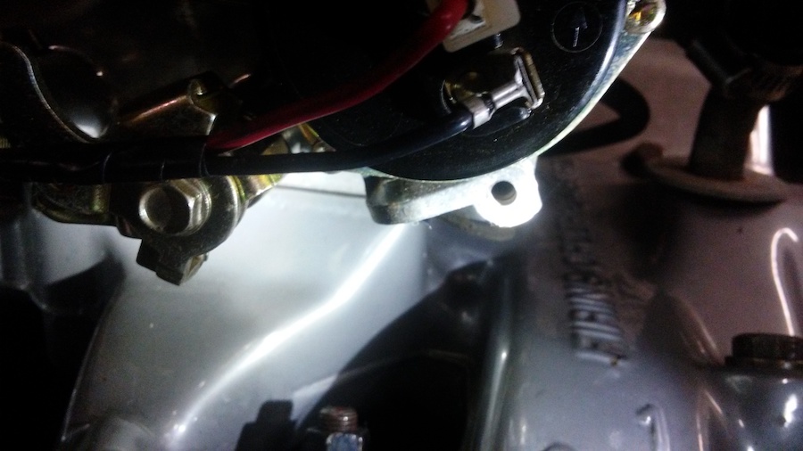

http://forums.y-blocksforever.com/uploads/images/547fad17-9b32-45b6-8286-4c0.jpeg
I have a 1406 Edelbrock carb on my 272" engine. I was checking for vacuum leaks around the base and found air entering the electric choke housing at a +/- 3/16" round hole just below the cover. See the picture. Does this serve a function of the choke, or should it be plugged?

I wonder if that is there for a heat tube,vacumn is used to pull heat up through the thermostat and if it works fine then plug it.
Most electric chokes will have an exposed port somewhere around the choke coil mechanism that exhibits a vacuum ‘leak’.  That’s an air flow path to keep the electric choke coil from overheating.  The earlier model Holley carbs with the electric chokes had a filter screen over that port but I don’t see that on many of the new carbs being sold now.  The pre-electric hot air chokes with the external tube running either through the intake manifold or to a 'stove' at the exhaust manifolds also had a vacuum leak or air drawing through them so that the bi-metal choke coil would work properly.  Without that draw of air over the choke coil, the bi-metal coil would not be able to sense the hot air coming through.

I found one post that said it is a vent to atmospheric pressure for the choke pull-off. The pull-off is a piston, therefore some leakage around it sounding like a vacuum leak.
I found several pictures of the choke and the hole is open in all of them. I'm going to leave it alone.
