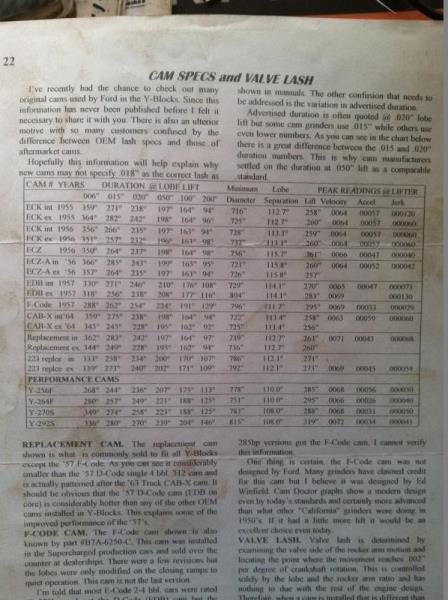

I know this has been covered, but a search didn't turn up what I wanted.  Any one have the specs on the 245 HP 57 cam?
