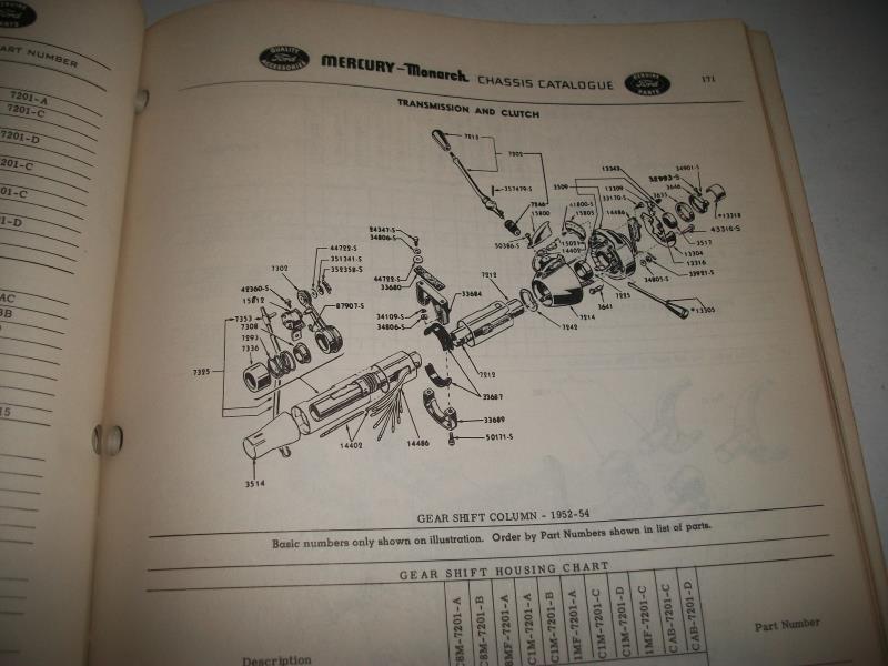

Does anyone have a diagram/picture and parts list for the column mounted switch and hardware that go on my car? The one I have was scabbed on using homemade parts and a modified switch.  I bought a new switch but my linkage doesn't work with the NOS switch.
Here's an Illustration. Not sure what You are missing or has been modified. http://forums.y-blocksforever.com/uploads/images/1af0d728-c964-4611-8cfc-0d00.jpg
martyk98
Posts: 160, Visits: 31.8K
Thanks for the picture. I think what happened on my 54 Monterey was a previous owner replaced the stock exhaust manifolds with newer ones which crowded the original placement of the neutral safety switch.  I bought a new switch but trying to get the switch to cover both park and reverse for the back up lights is impossible.  Plan B is to install proximity switches down on the linkage near the tranny, out of sight. My anal friend and mechanic has scabbed the switch to a working position but the assembly and linkage is hideous. I have threatened to post a picture of his concoction on the internet which met with immediate hostility. LOL The prox switch idea was his.
