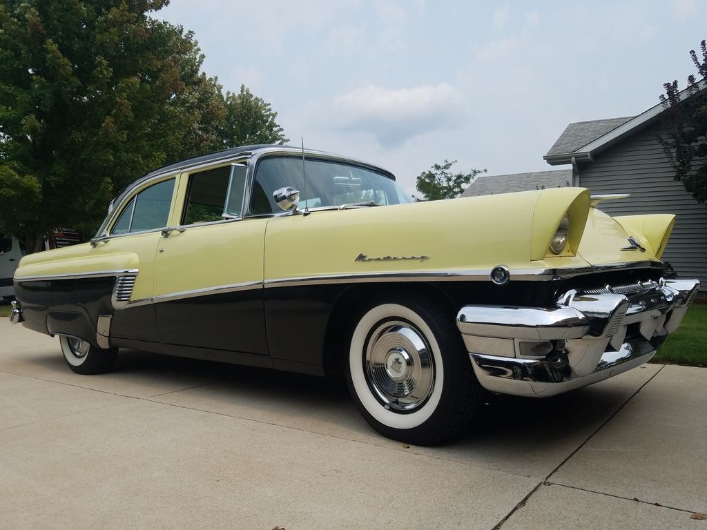

Hey guys, just picked up a 56 Mercury Monterey.  Really good condition, I think (new to cars).  Few things that need repaired over the winter; fix a few oil leaks, try to get the turn signals, radio, and wipers to work, and upgrade to dual master front disc brakes.  I've been searching, and have found a few kits, but have also found a few articles about buying everything at the junk yard to do it on the cheap.   Wondering if there isn't someone that knows the exact year  (granada or other car?) to buy new parts from say (rock auto) and piece together a kit for any cheaper than the pre-assembled ones?
