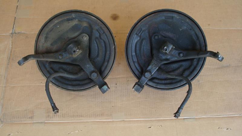

The elevation of the spindle axis - above the lower ball joint mount is the change that lowers the chassis. On an older spindle - or one for a full size car - the axis of the spindle is in line with a "lathe center" found on the lower ball joint lug.
http://forums.y-blocksforever.com/uploads/images/55d41608-c490-479a-a3db-7e99.jpg
These above are drum set-ups off a 65 Galaxie and the lathe center is clearly visible.

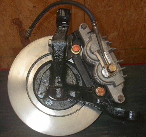

The disc set-ups available are many - I built mine off a '71 Mustang drum spindle - but the later designs have a lathe center above the lower ball joint lug.
http://forums.y-blocksforever.com/uploads/images/44764e5e-1a64-41fb-af91-a8a4.jpg
The relocated spindle design shows plainly in the photo above - moving it up relative to the lower joint not only lowers the assembled ride height, but it also moves the upper joint away from the tire sidewall. These parts also are a bit shorter in vertical height - the center to center height of the ball joints is lower. Depending on how deeply you set the lower ball joint when you ream for the larger early taper size, the set-up even moves the chassis lower. This design isn't necessarily the best for sporty handling geometry - taller uprights would be preferable - but the strength and ability to put some serious brakes on there is a good idea.
