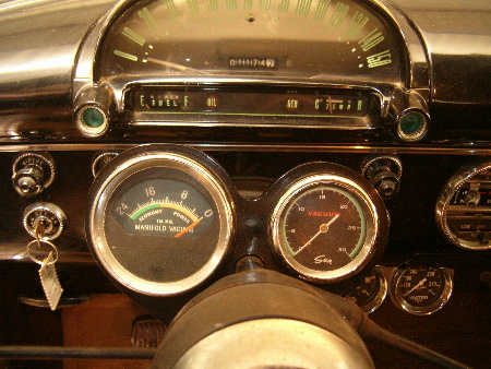

Posts: 7.4K, Visits: 205.0K
I have two vacuum gauges in my ’55 Customline.  The larger gauge is for the manifold vacuum while the other is for the distributor vacuum.
http://forums.y-blocksforever.com/uploads/images/3ac1121b-bfba-4bde-a01a-3dfc.jpg
