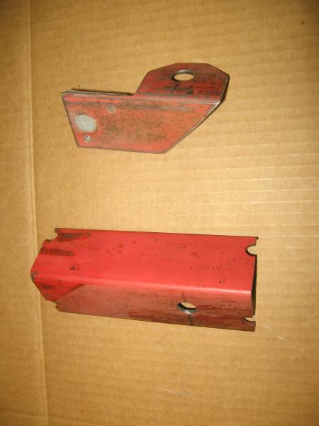

Thanks for the Pictures.That switch is very similar to '75-'79 Ford Pickup Switch

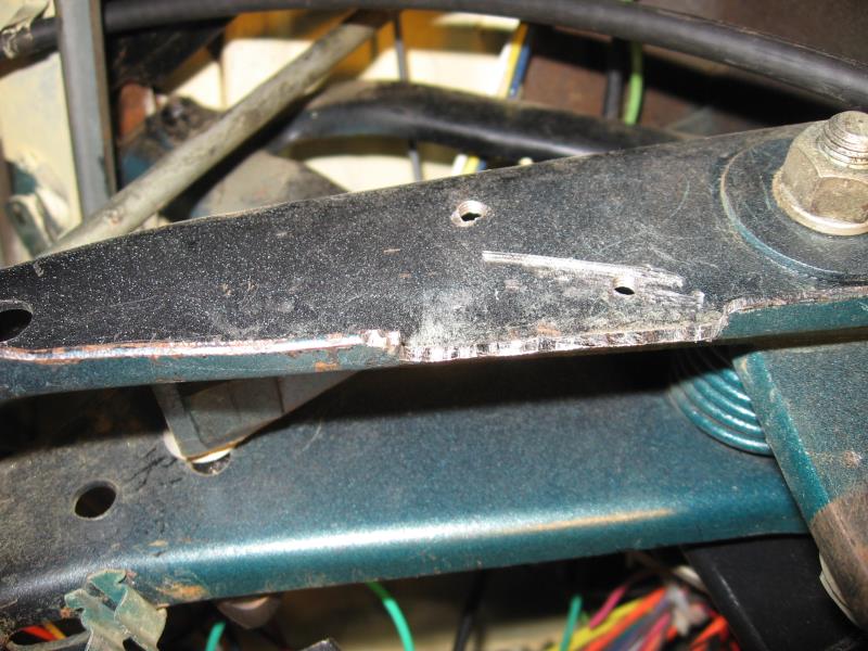

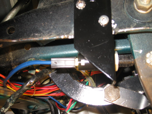

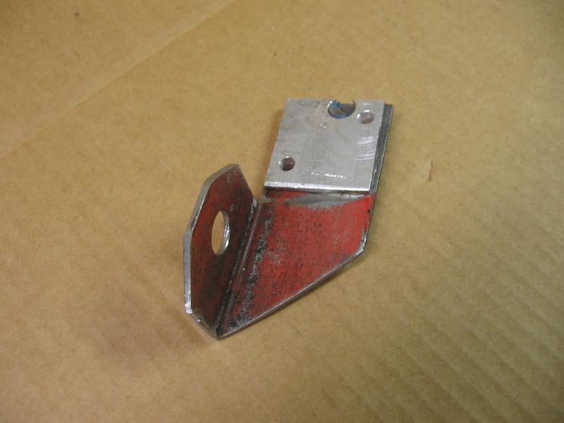

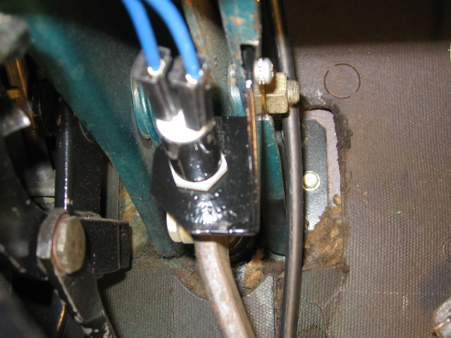

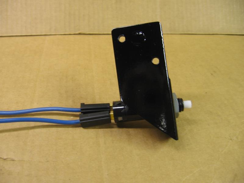

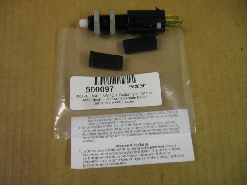

Here's some pics
http://forums.y-blocksforever.com/uploads/images/25431c75-ba80-4bb2-9e3a-cfe0.jpghttp://forums.y-blocksforever.com/uploads/images/83132be6-dd45-48a6-aa48-5405.jpghttp://forums.y-blocksforever.com/uploads/images/a6857b00-4e7c-4161-b77d-fe66.jpghttp://forums.y-blocksforever.com/uploads/images/913f719b-c366-4d81-9979-5c25.jpghttp://forums.y-blocksforever.com/uploads/images/da6be720-949b-4f1f-92b5-dc3d.jpghttp://forums.y-blocksforever.com/uploads/images/03478b3b-0fdf-4e71-868f-9dee.jpghttp://forums.y-blocksforever.com/uploads/images/f3918a64-cba7-43d0-8e7a-3b26.jpg
For electrical connections, one goes to the brake switch wire coming out of the steering column and the other to a power source.  If your hook it up to the accessory pole  or the main power pole on the ignition switch you must disconnect the old wires at the hydraulic switch as you will get feedback to the idiot lights.  I hooked up mine to the power source at the light switch as recommended by the Tbird parts suppliers who have a kit for the Tbirds.
I have a narrative on how I did it if your interested.  It's kind of long so send me your email address and I'll send it to you.

Oldcarmark, many have used the under floorboard switch from a GM trucks from 49-59 they have a place to bolt them to a bracket you need to make which can attack under the dash. I've seen them mounted to the steering column. These arm switches are very robust since they are normally under the car in the weather.
Posts: 4.6K, Visits: 37.7K
I also am using a lever mechanical switch. Hardest part was making a bracket for it. I've also heard of people using a switch from a Harley Davidson. It is said they screw into the same spot but require much less pressure to activate.
