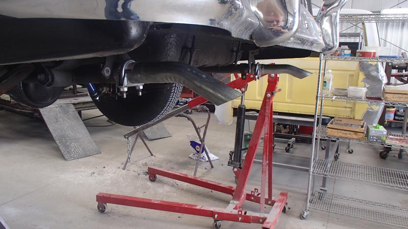

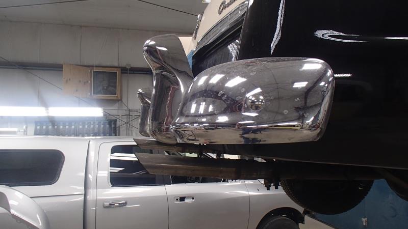

That's all it took, no fumes in car now. Yes stockers did exit out the rear but they all had down turns on them, the 56 came out the rear bumper but it was pretty far to the outside of car- all I know is this worked on my car. Thanks.

http://forums.y-blocksforever.com/uploads/images/b5f45388-57f2-4e56-bc08-b10e.jpghttp://forums.y-blocksforever.com/uploads/images/f9664e13-3233-44a5-a54e-ea89.jpg
