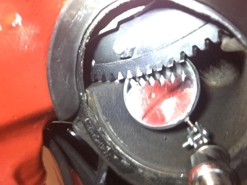

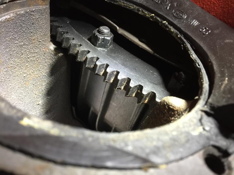

Can the ring gear be installed backwards?

Thank you for the suggestion. I'm not sure how you can tell if it was installed backwards but I'll check it tomorrow

taper on the ring gear to the rear of the flywheel.oposit to modern starters
Are you sure the rebuilt starters are for a y-block?  Later F.E. (332,352 etc) starters are of two types that will bolt in, however units after 1964 (iir correctly ?) engage from the front, not the rear as is correct in a Y-Block.. just checking?

I cannot see any taper on the ring gear. I've posted two pictures of the ring gear please let me know your thoughts if you can see a taper.

I believe they are correct. One was the original starter that I had rebuilt. Good suggestion Paul I appreciate your input
