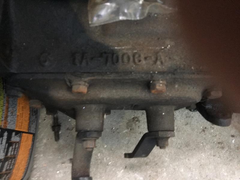

Can anyone help me id this 3 speed OD trans?
It came in my 56 Customline. Is it indeed a 56 trans?

It may be a '56 trans but Ford used that trans from the 1949 model...

Not sure if you can nail it down to a specific year by that casting...

Jim, you are right, 1A casting number would suggest 51, but were used...

Assuming there are no other identifying tags or marks on the housing,...

The T86 is a top loader. The plate is on the top of the trans. T85 has...

I think thats just the light duty 3 speed with R10 OD. T85 has a side...
