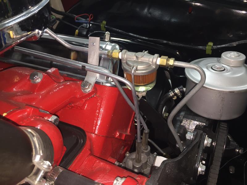

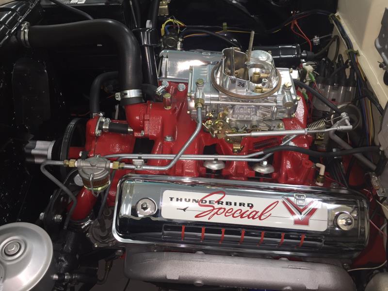

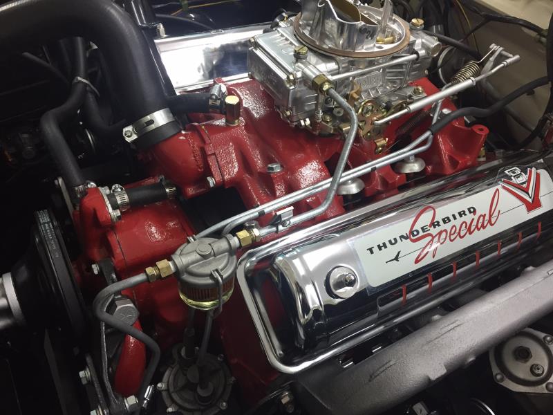

petew
Supercharged (306 reputation)Supercharged (306 reputation)Supercharged (306 reputation)Supercharged (306 reputation)Supercharged (306 reputation)Supercharged (306 reputation)Supercharged (306 reputation)Supercharged (306 reputation)Supercharged (306 reputation)
Posts: 178, Visits: 5.0K
http://forums.y-blocksforever.com/uploads/images/8f6cf4c8-2ec1-418e-96c9-28b6.jpghttp://forums.y-blocksforever.com/uploads/images/f0d90b9c-31b1-4437-988f-d8b7.jpghttp://forums.y-blocksforever.com/uploads/images/dcdeb537-479c-4a52-a0a7-48aa.jpg
petew
That's what the Thunderbird lines look like on my 312. I try to never use rubber lines on the pressure side ( fuel pump to carb) since ethanol tends to do nasty things to it.
