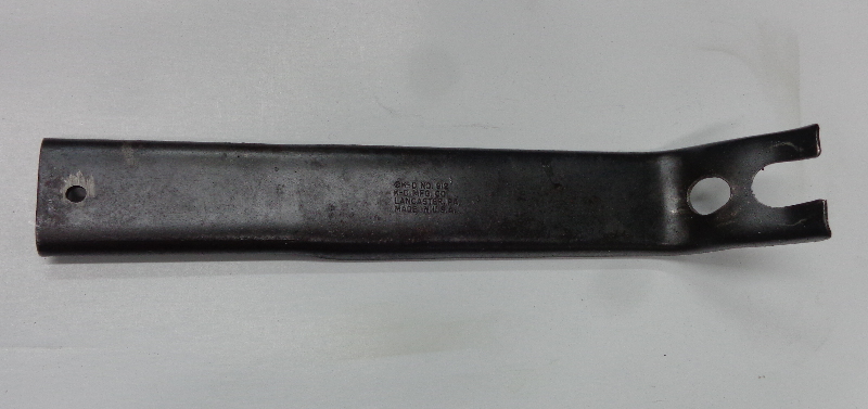

Anyone made a tool to remove springs off yblocks with heads still on ? If so would you have a photo of tool available?

Thanks guys I was hoping to find something other than the hooks with the big thumb screw. I had an idea I might use an old rocker shaft with towers and make one from a rocker , maybe weld an open end wrench portion and make a fulcrum. I'll figure out something thanks.

Here are pictures of a couple of the tools I use with a rocker shaft devoid of the rockers for removing the valves springs from a cylinder head with those heads still on the engine.
http://forums.y-blocksforever.com/uploads/images/f0f0c5b4-3fc2-4c81-9b98-57a9.jpg
http://forums.y-blocksforever.com/uploads/images/e85d421f-a870-495e-8661-8b95.jpg
