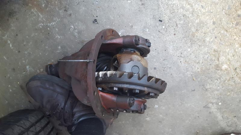

Just re reading the posts. Does your rear end have a cover on the back? Not a pumpkin type? If so its a Dana rear and that shouldn't be such a terrible job. I would get a new gasket though. There are some sealers that a "gasket makers" not sure how good they work but its not a big gap to seal. I would think, lacking a gasket it would work. Pictured is a pumpkin type or center chuck rear end.

It is the pumpkin type and looks like the one you pictured, that is why I decided not to do it.   Thanks Mike
